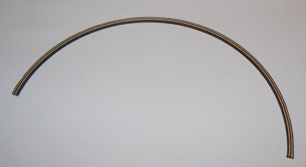

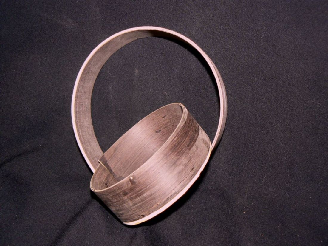

I have been meaning to put this up for while. I found the process of laying the purfling a bit tricky and wondered whether there was an alternative approach. I had been messing around with a homemade vacuum and thought that I might be able to form the rosette grouping of purfling veneers in the round.
The process entailed wrapping the veneers, polycarbonazte sheet, vinyl vacuum sheet around a pipe and applying the vacuum for about an hour. The formed rosette purfling was then sliced using the fret slotting saw to produce 0.080"/2mm slices.

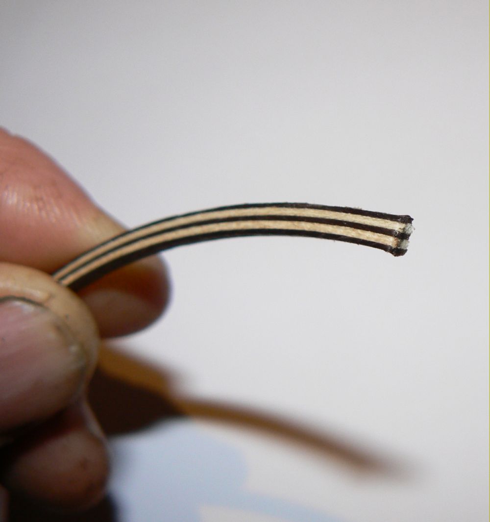

I had an opportunity to take a couple of close up images. I will put up a few images of my vacuum form tomorrow

Tim that worked very nicely.

That is correct however I should qualify it by saying that I tape up the lamination end to complete the circle and then place them in a cradle just above the fret slotting table saw blade and revolve the form to slice the rosette laminations. I will make sure I post a few pictures tomorrow.
